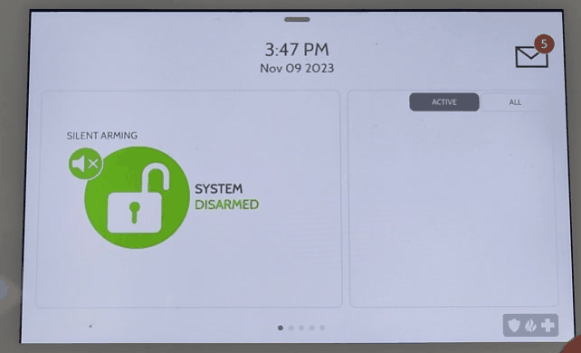

To reboot the IQ Panel 4, pull down the menu and navigate on the panel screen:
- Tap Settings
- Tap Advanced Settings
- Enter your master user code or installer code
- Tap Panel Reboot
If you need to power the system down for a longer period of time, instead select Power Down.
If the panel screen is not responding, hold the side power button for 30 seconds to reboot.
